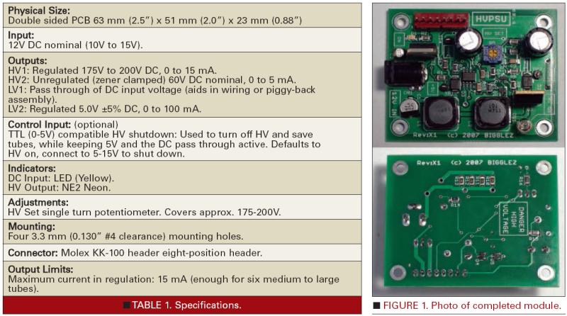

Juist gezien dat in Nuts&Volts van deze maand een mooie nixie HV voeding wordt besproken.
quote:
High Voltage Power Supply Unit
by Peter Stonard
It's fun to collect and experiment with forgotten technology! But, you'll need a stable high voltage power supply to get started.
Before solid-state electronics, vacuum tubes were used for everything - from high volume consumer radios and televisions to exotic one-of-a kind military and scientific applications. A lot of the old and interesting glass is still around to be found at hamfests, estate sales, and online auction sites.
PCB en BOM is gratis te downloaden op http://www.nutsvolts.com/downloads.php?68
