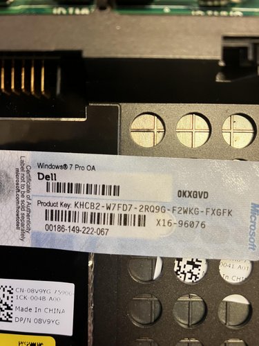

Schakelt ie naar ook na een paar seconden weer aan? Dat heb ook eens gehad, een afgebroken nagel zat klem tussen de aan/uit knop en bleef ingedrukt staan.
De voeding hangt aan de stekker.
De accu links onder met de gele sticker.
[Bericht gewijzigd door maus0611 op (40%)]

Dit komt van een forum ik kan beamen dat dit kan helpen. Mijn exemplaar was DOA verklaard via de helldesk Ireland. Je kan het evt vertalen via Translate easy.
What you need to do is pull the back cover off and unplug both the main battery and the CMOS battery. You need to be very very careful removing the CMOS battery. Do not pull the battery out by the wires. I find it’s best to use a plastic pry tool of some form, whether it be a spudger, old credit card or some other thin semi-semi blunt plastic tool. If you rock the two sides back and forth then push out the connector down the center, it will come out. The CMOS battery looks like this: https://guide-images.cdn.ifixit.com/igi/rWTpWLLvSdZ36TQU.large
Once you have both batteries unplugged, hold the power button for 60 seconds. Yes, really, 60 seconds. Plug both batteries back in and plug in the charger, then attempt to turn the laptop on. If all went well, the CPU fan should spin over a few times before the machine finally boots back up. Put the cover back on and you’re done.
Source: I’ve been working in IT Support/Management with Dell as our main vendor for the last 12 years.
