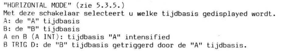

I am looking for a manual for Dynatek 9100. I am planning to get one of those but cannot find anything online about any of 9000 series oscilloscopes. I found info only about the 8000 series. Most of the things are clear but there are some options, for example like "A INT", "B TRIG'D" which I am not sure what they will do. Also, it is not clear where there are 2 knobs for the time-scale (horizontal) and why they are different (looks like only one channel can get to 100MHz), and it would be nice to have a schematics.

This scope has 2 time bases (horizontal), A and B. The channels are called CH1 and CH2 (vertical). Both channels are using the same (selected) time base.
Time base B is the dayed time base, where you can (analog) zoom.
Thanks, indeed it was a bit of confusion between Ch1 Ch2 and A, B. I also found in the manual from 8000 series some explanation about the "A INT", which clarifies the thing (also attached here). Now I am going to check the LG9100 manual. Long time ago I was using a simpler oscilloscope and more recently a USB-based one. Thanks!
