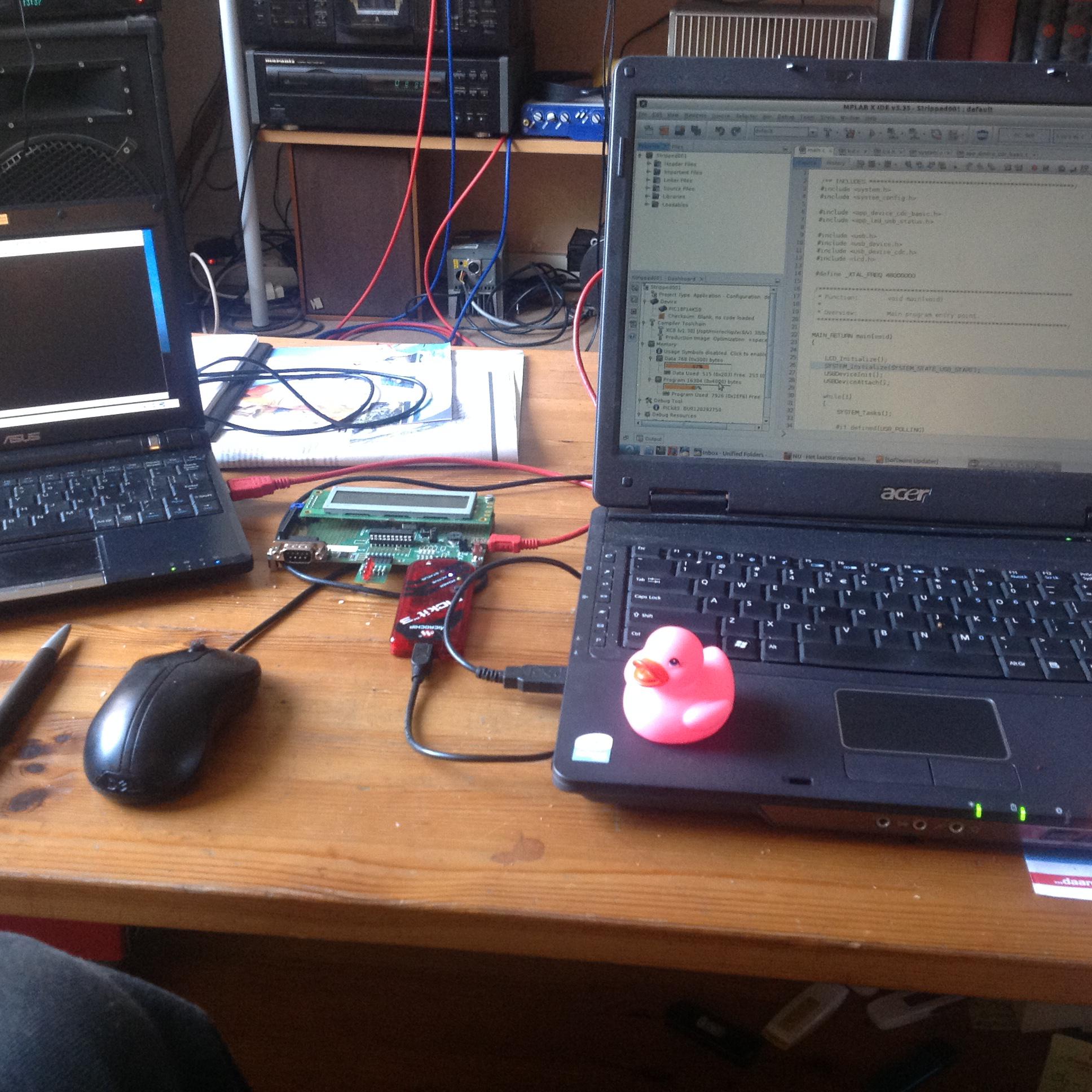

Op 17 augustus 2016 09:08:28 schreef Jochem:...gewoon elke regel assembly in je hoofd 'uitvoeren'...
Dat is bijna rubber duck debugging, de beste methode om fouten in je code te vinden. Een programmeur kan niet zonder.

Gehaald van http://www.rubberduckdebugging.com/
Step 1) Beg, borrow, steal, buy, fabricate or otherwise obtain a rubber duck (bathtub variety)
Step 2) Place rubber duck on desk and inform it you are just going to go over some code with it, if that's all right.
Step 3) Explain to the duck what your code is supposed to do, and then go into detail and explain your code line by line
Step 4) At some point you will tell the duck what you are doing next and then realise that that is not in fact what you are actually doing. The duck will sit there serenely, happy in the knowledge that it has helped you on your way.
Note: In a pinch a coworker might be able to substitute for the duck, however, it is often prefered to confide mistakes to the duck instead of your coworker.
