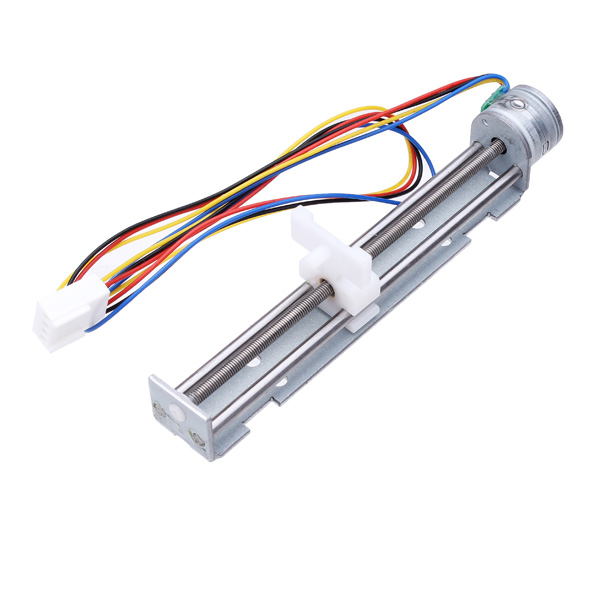

Stappenmotortje met lead screw?
Kost quasi niks, overal te koop.
