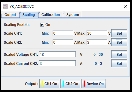

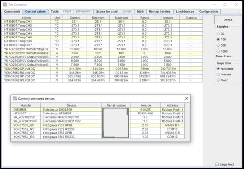

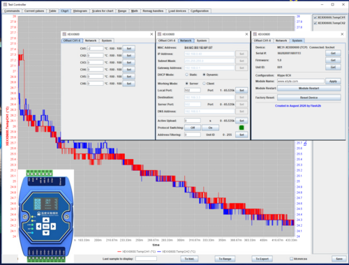

Alweer een nieuwe versie van TestController:
V3.04 is up
It got a new automatic test function, more bench meters and a lot of modules
Added: Keithley 2001, 2002, 2010 Bench DMM's (Thanks KungFuJosh)
Added: PS and DC/DC converter automatic test, it controls a load, a source, thermometers and DMM's
Updated: Minor modifications to battery test
Added: Elecdemo YK-LED23004M, YK-LED23006M 4 & 6 digit 7 segment display module (Thanks Flash2b)
Added: Elecdemo YK-LED3604M, YK-LED3605M, YK-LED3606M, YK-LED5604M, YK-LED5605M, YK-LED4006M, YK-TMLED3904M, YK-MILED3906M 7 segment display module (Thanks Flash2b)
Added: Ebyte AXCX4020, XACX0420, AACX2220, AXCX4040, XACX0440, AACX2240 and XXCX0080 Isolation AI-DI-DO module (Thanks Flash2b)
Added: UNI-T UT8805 DMM (Thanks squirrax)
Updated: HSPY-400-1 and Kunkin KP184 to support modbus sharing interface (Thanks Flash2b)
Updated: Flash2b has updated all Eletechsup and a few other to support the modbus sharing
Updated: GWInstek GPP-4323 Power supply, names adjusted (Thanks flash2b)
It works in a way very similar to the battery test.
The new automatic test function can test power supplies and DC/DC converters, it will do 3 type of test:
Point: Test a specific working point and record all data in a table.
Load sweep: Sweep load from 0 to maximum while recording data
Load test: Run for some time with a specific load (Useful for logging working temperature).
All tests can automatic be performed at a couple of different voltage and currents.
Charts and CSV files are saved of all tests.
Help page for function: https://lygte-info.dk/project/TestControllerPopupPSTest%20UK.html
Power supply test example: https://lygte-info.dk/project/TestControllerPopupPSTestExampleAC%20UK.…
DC/DC converter example: https://lygte-info.dk/project/TestControllerPopupPSTestExample%20UK.ht…
The popup may still have issues, it support a wide variety of configuration and I have not tested all of them.
Also not default parameters are for testing the popup, the test time must be much longer to do real tests.

Versie 1.10 van deze definitie ondersteund zowel RS232 als GPIB versies van de Yokogawa 7551, 7552, 7561, 7562 en 7563.
Dit was een stuk moeilijker als jouw Fluke voorbeeld. HKJ heeft een aantal initialisatie commando's geschikt moeten maken zodat portType al bij identificatie is te gebruiken (TC v3.34). Na dit kon ik mijn meter identificeren op beide interfaces in één definitie.
Maar toen was ik er nog niet, het uitlezen van gegevens is ook per interface verschillend voor deze meters. Als ik portType zou gebruiken, dan moest ik veel scpiCmd's ombouwen naar #pgm# en dat wilde ik niet. (ook niet wenselijk kwa snelheid)
Ik heb gekozen voor een aparte #metaDef per model + interface type, zodat ik het met een #metaSection heb kunnen oplossen. (TC v3.41)
Deze meters hebben trouwens een kort en een lang model nummer, 7562 én 756201 voor GPIB of 756202 voor RS232 dus dat loopt mooi synchroon.
Hieronder zie je 4 stuks van deze meters (+ 4 andere devices) in actie.... De handles zijn geremapped naar voor mij handigere namen.

Een aantal van mijn definities heeft extra functies die niet één op één door door het aangesloten apparaat worden ondersteund, maar wel handig zijn. Hierdoor kan het apparaat dus meer als oorspronkelijk ontworpen.
De definities van mijn Analog Output (AO) modules hebben een scaling functie ingebouwd waardoor voedingen zoals de Delta E30 analoog kan worden aangestuurd door TestController met gebruik van de normale ranges/bereik die de voeding ondersteund.
Hieronder zie je een voeding van 0 to 30V en 0 to 3A aangestuurd via een Elecdemo AO module waarbij TestController gewoon kan Param Sweepen van 0 naar 30V terwijl de module dit vertaald naar bijvoorbeeld 0-5V stuur spannning of 0-20mA stuur stroom.
Hierdoor kan je een oude analoge voeding toch in TC gebruiken. Min en Max zijn zelf te definiëren, de Scaled range wordt dan automatisch aangepast, en de resolutie is natuurlijk beperkt door de AO module zelf. Je kan gewoon het commando geven zet de voeding op 18V met stroom begrenzing op 3A net als een digitale PSU.
Ook mijn remote readout module definitie hebben extra functies zoals floating-point en SI formatering van getoonde waardes. Het eerste zit bijvoorbeeld niet in de Eletechsup modules en heb ik er zelf bij geprogrammeerd. De gebruiker van de definitie merkt daar niks van en het lijkt of de module alles kan en alles ondersteund wordt maar het programma in de definitie doet al het werk.
