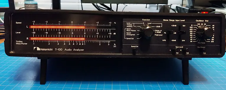

Is de softwarematige implementatie van de Nakamichi T-100 niks?
http://www.anaxwaves.com/NAKT100/
