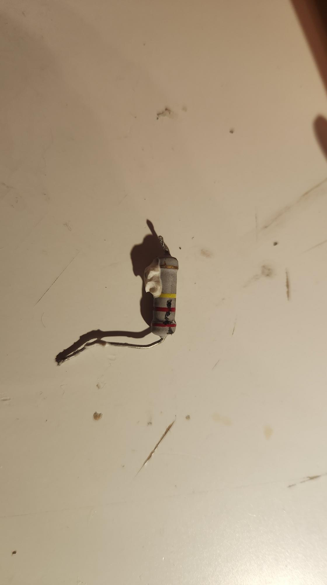

Der Widerstand war leider auf Giga Ohm, da kann ich nichts messen
Then that is the problem. I'm 200% sure there are no GΩ resistors in a smps. So that resistor seems to be open so dead. Replace that first.
Op dinsdag 4 november 2025 22:46:01 schreef fred101:
[...]Then that is the problem. I'm 200% sure there are no GΩ resistors in a smps. So that resistor seems to be open so dead. Replace that first.
Ja, da gebe ich dir recht. Er hat auch schwarze Stellen, aber es sieht nicht so aus, als wäre es verbrannt. Die Farbcodierung ist Rot, Rot, Gelb, Silber, Gold, was meines Wissens nach 224x10? Ohm 5±% sind.
You probably have the colors wrong. If it is the resistor that is limiting the current for the opto led then it will be absolute not in the giga ohms. It wil be a few hundred to a few thousandth ohm. 99,9999999999% of everything electronic ever made will not have Giga ohm resistors.
What does that resistor measure?
If you have tested the opto with a lab powersupply and that resistor and the opto is OK then the resistor must be OK too. If you tested the opto on a power supply and without a resistor, then the opto will be now dead.
The right way to test an opto is measuring the current transfer ratio(CTR) . You need 2 labsupplies and 2 multimeters to do that. But a go-no go test can be done with 2 DMM's. Opto's die not often but after many years the CTR can become to low.
Check those ceramic resistors. Some of those can be fusible. Have you tested diodes, transistors and mosfets already? Use the diode test of you DMM. Most times you need to desolder them first. (In situ is possible in some cases but you need experience to know when the measurement is correct.
SMPS are not easy if you have no knowledge and no gear. Normally you search the datasheet of the smps controller and use a scope (and diff probe) to see if it is switching. If it is not switching and the mosfet is good and the correct voltasges are on all pins then the IC is dead. Without a scope you will not know. Sometimes a thermal camera will show if it is getting to hot or stays stone cold. Most things that fail in consumer stuff are electrolytics.

Das kann natürlich gut sein, dass ich die Widerstände vertauscht habe. Ich kenne nur dieses eine Messschema. Ich habe, als ich den Oktokoppler getestet habe eine 3V Knopfzelle mit einem Widerstand von ca. 500Ohm angeschlossen. Er hat funktioniert, so hatte es mir Chat GPT beschrieben. Kann natürlich trotzdem sein, dass er kaputt gegangen ist über die Jahre. Ich werde mal weitere Messungen der Dioden, der Widerstände und weiterer Komponenten durchführen. Wie heisst die App, die sie nutzten um den Widerstand festzustellen?

[bijlage]Where is that 2,24 ohm resistor located? What is it's function?
Er befindet sich ja direkt neben dem Transformator und wenn ich mich recht erinnere ist er in Verbindung mit dem großen Kondensator. Letzte Messung dieses Widerstandes ergaben OL. Ist er vielleicht wirklich dann kaputt? Ich dachte halt, dass Rot, Rot, Gelb, Silber in die GigaOhm Richtung geht. Aber dann sind es wohl nur 2,24 Ohm, dann wird dieser defekt sein. Ich werde diesen nochmal durchmessen, er sollte ja dann 2,24 Ohm anzeigen. Ich berichte später!

That opto still will be good then. A buttoncel can not deliver enough current and 500 ohm is also enough protection. Optos do die but that is rare. If they are the problem then the led has become dimmer and the transitor wil not switch totally on due to a lower CTR.
OK, so that is "the" resistor. That is probably a fusible resistor. That is a resistor that goes open without burning. But that is not very good news, it is open because something downstream failed major and drew to much current. Often there is more dead and the resistor did his job by going open. My first guess would be the "switch" probably a MOSFET.

2.2 ohm zou in serie kunnen staan met de schakel fet, als feedback voor de stroom. Als die ‘open’ is doet de voeding inderdaad niks meer. En het is waarschijnlijk een fusible (zodat ‘ie open faalt bij overbelasting)
Heel misschien is er verder niks stuk. Met wat pech is de controller stuk. Ik denk dat dat het kleine IC op de onderkant van de print is, waar boven ook een gewone THT footprint zit waar niks geplaatst is.
Als het de startweerstand is zou ik een paar honderd kilo-ohm verwachten. Maar als serieweerstand van de schakel transistor is 2.2 ohm een logische waarde. Dan zou ‘ie in de source van de fet zitten (tussen fet en gnd). Als die weerstand dan open gaat krijgt de controller een hoge spanning op zijn feedback pin, ik weet niet welke controller het is en dus ook niet of ‘ie daar tegen kan, vandaar: met wat pech is de controller stuk.

Ich habe eben nochmal nachgeschaut, er müsste Rot, Rot, Gelb, also 224 Ohm haben, es zeigt OL. Das ist der Widerstand, der schwarze Stellen hat, den einer von euch nochmal reingeschickt hatte. Kann das der einzige Fehler sein?
