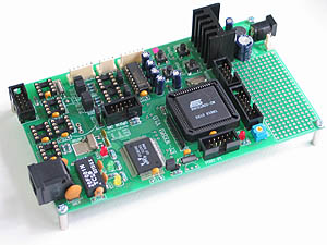

Wou geen PC 24/7 aan hebben dus het volgende board gekocht:
http://www.futurlec.com/Pictures/Web_Control_Board5.jpg
Web Control Board
Introducing our new exciting Web Control Board, the new Futurlec Web Control Board allows you to control devices and receive information via a standard TCP/IP network, including the Internet. The Web Control Board includes the new Atmel AT89C51RD2 Microcontroller featuring a large 64kB Flash Program Memory combined with the very popular RTL8019AS Full-Duplex Ethernet Controller, to support the communications interface.
Na 2 maanden "stoeien" had ik 't eindelijk werkend, zat source code met commentaar in het pools bij ...
