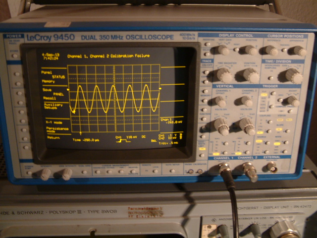

Le Croy 9450 DSO :-)
REPARATUR: I am searching 2 input modules for this Beauty, the 1M inputs are not working. 50 Ohms = OK
If you mean the HHZ406 module, someone from the the Yahoo user group “Lecroy Owners group”, has designed a HHZ406 replacement. (Dieter Frieauff.) It's in their file section, but to access it you need to join their group. (Or if you send me an e-mail I'll send you the files, click my nickname for my address) (it's not a plug-and-play replacement, but it's a lot better than unobtainium)
The "Leidse Makerspace" has the same 'scope, with a broken ADC card and a broken HHZ406. http://lukelectro.wordpress.com/2014/01/26/lecroy-9450-oscilloscope-re…
Sure is a beauty.
