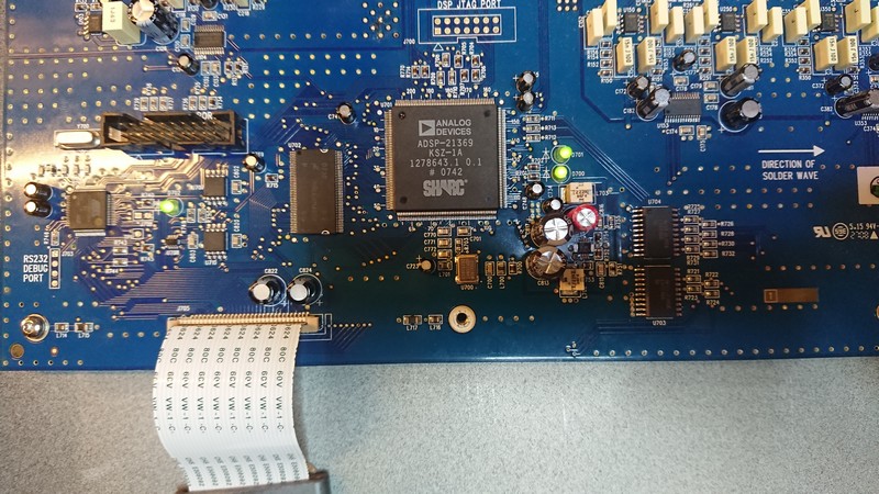

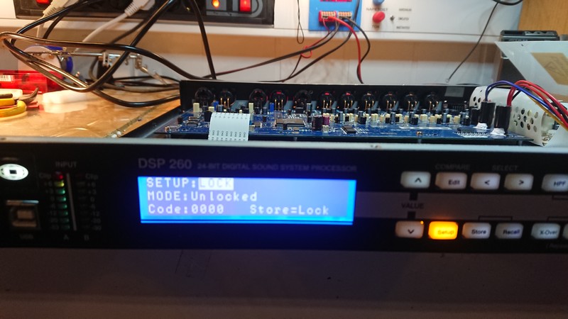

I have problem with Dynacord DSP260 from my friend. DSP is turning on normaly and also working, but somethimes suddenly freezes (when pressing some combinations of buttons, for example tried to change contrast,...).

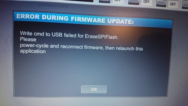

Connection with software (DSP editor), also isnt working. I can install it and it is showed in device manager. When program started they notice about flash upgrade, but when starts DSP freeze and upgrade is also cancelled.
I measured voltage and check for some caps, but everything seems ok.

DSP also freezes always, when I connect it to PC and start the program. Window about firmware update is showed, but DSP is already freezed.
About drivers, I installed like you said, and I can see DSP normaly in device manager.
I also think, that DSP freezes when LED D700 is turning off.
What do you think. Can you send me the firmware and tell me how to flash ARM. Which software and programmer do you use?

Do you mybe know what is function of LED D700? DSP always hangs when this LED is turning off.
There is no possiblity to connect software with DSP. I tried another computer, another USB cable and is the same.

At this point i do not have any clue's what wrong with it. I have repaired a lot of DSP260 and DC-one's, but never had one with this problem. Where do you live? If you give up, maybe i can buy them from you? I have a lot of these units in maintanance, but parts are very hard to get.
The LED's are to show if the microcontroller is functional.
