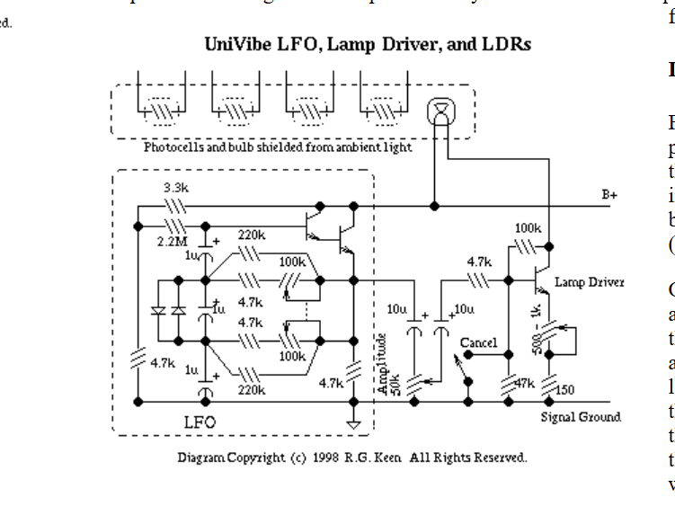

Hi guys, once again I'm going to do this in english to make it a bit easier (given all sources I found on this topic are in english). I have recently built a shin ei univibe replica from the late 1960's. There is a lot in the circuit, but right now I am having some issues with the LFO, Ibelieve at least.
The situation is as follows: I got it to work perfectly, when I installed it into the chassis I shorted some things on accident and fried some transistors. I have now replaced all the transistors and the circuit works almost perfectly, I am getting the right sound form both the vibrato and chorus section,
BUT
The bulb doesn't oscillate slow enough. right now it only does a very fast flicker and when I turn down the speed it stops flickering and just sit on at full brightness. What could this be?
I shared the pcb layout I am using and a more detailed schematic similar to the the LFO/ lamp driver of the pcb (the princible is the same in both).
Here are some things it almost definitly is not:
I am using a stacked potentiometer (100k) for the speed, as specified, so this shouldn't be an issue, and all the wires connecting to the pots end in and outputs are also perfect. So I am thinking it might be a capacitor? But I dont know which one could be responsible for this.
Any input will really be appreciated as I am very lost at the moment.

Het is een heel basic wien-brug oscillator, er hoort iets van een sinus uit die darlington te komen.
Heb je de potmeter zeker wetem goed aangesloten? Dat lijkt een vrij makkelijk iets om fout te kunnen doen.

Bron schema startpost:
http://www.geofex.com/article_folders/univibe/univtech.htm
Levert de oscillator wel zijn sinus af, ook op de laagste frequentie?
Zo ja, dan ligt het probleem vermoedelijk bij de instelling van de transistor in het 'lamp driver' circuit.
De tor staat dan gewoon te hoog ingesteld, en de amplitude van de oscillator (die bij lage frequenties ook lager is) is dan niet genoeg om de lamp zichtbaar te dimmen.
De in een eerdere post gegeven pdf laat daar al modificaties voor zien. Maar controleer eerst gewoon even de weerstandswaarden daar.
Hoe oscilleert die LFO ? beide torren staan in GCS, dus geen spanningsversterking. ergens in de lus moet er dus spanningsversterking zijn, zie even niet waar? of werkt de middenste C (met de twee diodes erover)als ladingspomp?

Volgens de link van FET.
A normal phase shift oscillator uses three RC networks from the collector of a transistor back to it's base, the gain of the transistor making up for the losses of the phase shift network. In this implementation, the stack of three capacitors and the two resistive legs of the 220K/4.7K/100K pots provide a net voltage GAIN (this is mildly astonishing to an EE, as you in general can't get gain from passive components) back to the base of the LFO darlington. This satisfies the criteria for oscillation, gain of greater than one and in phase with he input, although in a non standard way.
Ik hou het er voorlopig op dat er geen spanningversterking is maar wel stroomversterking.

Spanningsversterking, natuurlijk; vandaar die darlington. Een FET zou het daar nog beter doen.
Neem dit netwerk:
---+---R---+---
| C
+---R---+
C
-----------+---Stel R=1 en C=1.
Een momentje algebra leert dat de uitgangsspanning een maximum bereikt voor
ω = 1/3 · √(√19 − 1), ofwel f ≈ 0,09723
Dat maximum is
Umax = 1/15 · √(305 − 10√19) ≈ 1,0779
Met andere R en C krijgen we andere waarden voor de 'resonantie'-frequentie, maar de maximumspanning blijft hetzelfde.
Natuurlijk kunnen we ook een sim gebruiken, alleen brengt ons dat niet verder, want... daaruit komt precies hetzelfde
(plaatje onder de post).
(Door voor het bovenste RC-lid andere waarden te gebruiken dan voor het onderste, kun je de spanningsversterking hoger krijgen. Dat is in dit oscillatorschema niet gedaan, omdat je van die extra spanning tóch geen gebruik kunt maken: de fase wijkt dan teveel van nul af, zodat je niet aan de oscilleervoorwaarde voldoet.)
De bovenste 1 µF in combinatie met de 2M2 en de Ri van de darlington doen niet zoveel; ze zijn alleen voor koppeling en instelling van de tor bedoeld.

Zo heel ongewoon is deze oscillator nu ook weer niet. In de afgelopen tientallen jaren heb ik het principe toch heel wat keertjes voorbij zien komen.
Een Google-search naar 'RC-oscillator met emittervolger' leverde zo al onmiddellijk de Elektuur halfgeleidergids van 1976 op, waar hij als schakeling 84 in staat.
De theorie vind je o.a. hier:
https://www.oldfriend.url.tw/article/IEEE_paper/Synthesis%20of%20Passi…
Een wat modernere uitleg vind je hier:
https://www.ias.ac.in/article/fulltext/sadh/047/0267

Hoe kan ik dit meten? ik heb geen osciloscope, en alleen een multimeter.

De frequentie is zó laag dat je gewoon met de multimeter in de stand gelijkspanning kunt meten. Als de oscillator werkt moet je gewoon de uitgangsspanning (meet op de emitter van de darlington) op en neer zien gaan.

Ok, als ik van de emitter van de darlington naar ground meet, meet ik 16.1 volts. Het fluctueert niet, maar het lampje flikkered well, als ik de snellheid onlaag draai, dan meet ik nogsteeds 16.1 volts, terwijl het lampje gewoon normaal sheint. maar ik denk dat dit meer is omdat het lampje te snell flikkered voor mijn multimeter. als ik handmatig het lampje maak oscileeren dan krijg ik well een verschill van 15 tot 17 volts.

Met de 'darlington' bedoelen we de twee transistoren in de oscillator.
Meet het punt dat ik hier geel heb aangeduid.
Dat de oscillator het op hogere frequenties doet, weten we al. Het gaat om de lage frequentie. Zet hem dus op de lage frequentie.
Wat meet je dan op het gele punt (t.o.v. nul)?
Probeer eens of je een meter met naald kunt vinden/lenen. Dan zie je gemakkelijk of de naald rond een evenwichtspunt op en neer beweegt.
Of een gewone digitale meter maar dan met zo'n 'analoge' bargraph onder de cijfers.
