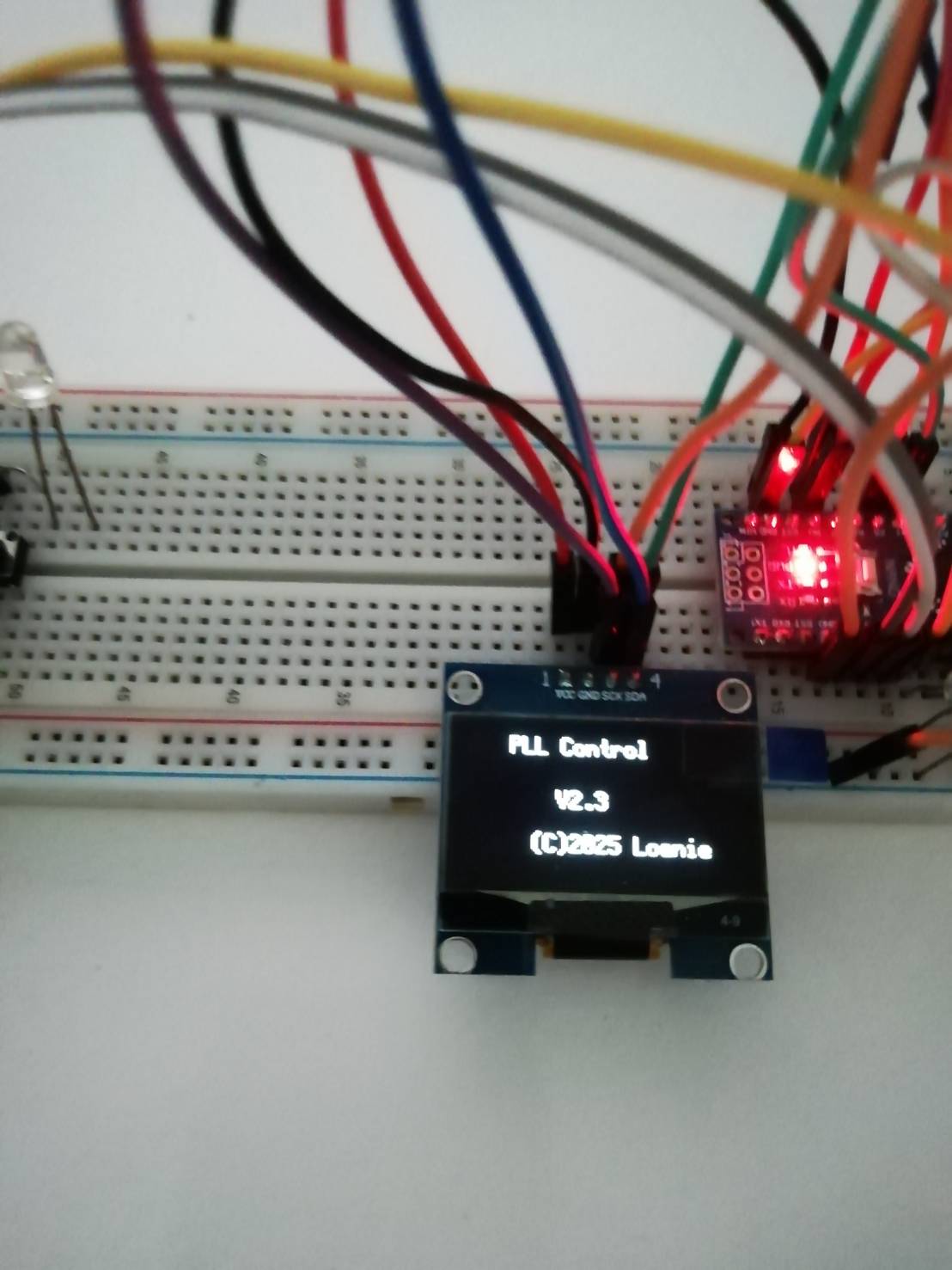

hello
I've tried to fix it so it works with OLED 1.3" screens, but it's not perfect. It's likely a problem with the SDA and SCL being used together with the TSA5511, but I still haven't found the cause.
Loenie
Ink fades. Voices die. So will I.
Op zaterdag 13 september 2025 07:30:51 schreef pued:
hello
I2C should not be a problem, since your OLED screen uses a different address (probably something like 0x3C). As I designed the UI for use with a 16×2 display, just printing to a display with a different ratio will screw up the layout, as can be seen in your pictures. You could either adapt the sketch to accomodate for a different ratio or make a wrapper (with cursor support) to make your OLED emulating the 16×2 ratio as expected by the sketch.
