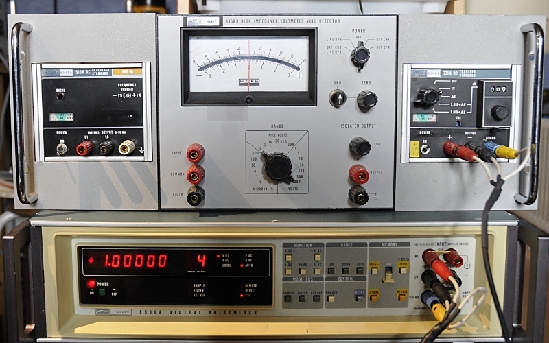

John Fluke 883A Differential Voltmeter
in Tek we trust
