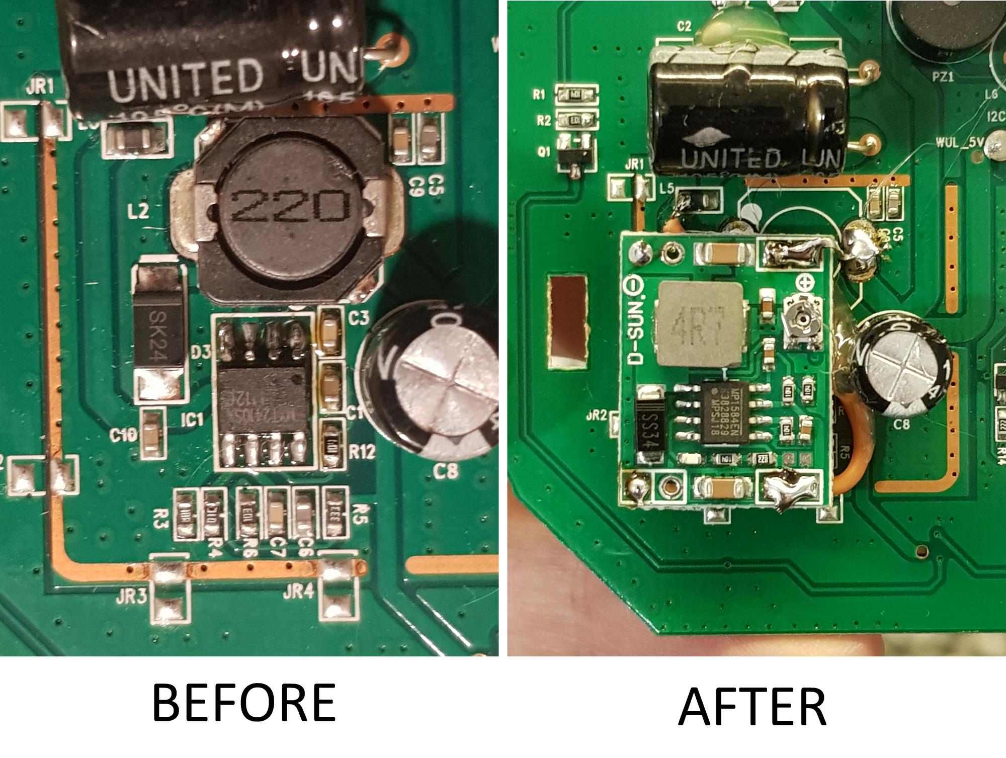

I was having a flickering issue with my HF3520 and this forum was very helpful. Similar to what Kruimel did, I replaced the power supply but with a commercial alternative that was easily accessible in my country (MP1584 psu module).

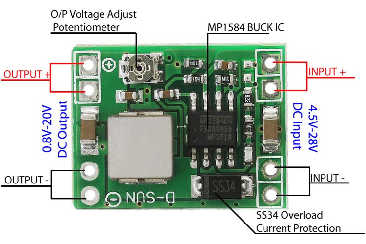

I desoldered the INDUCTOR and the buck controller from the HF3520 PCB and hot glued the MP1584 psu module.
This is the result:
This is the module I used:
Now the clock started behaving correctly. I hope this fix lasts! Thanks for all the help posted on this forum!

Well done, thanks for the addition. There may come a time that you'll have to replace some electrolytics as well.
Nice to see it worked!
I was thinking on doing what you did, but I got a bit suspicious of anonymous chips and modules after I found a few reports of people buying replacement chips that turned out not to tolerate 24V, blowing up the 5V circuitry. I have no idea how prevalent the failure of this clock is, the stories of wake-up lights just working usually don't get published, the chip seems to be a recurring issue though.
I chose a replacement chip that was still in production with a known manufacturer to avoid pitfalls with clones (the MX2410 and MP1584 are not in production anymore, the ones that you find are generally copies). I recommend anybody that uses one of these modules or chips to test their tolerance for 24V before putting them in, because the clock is actually quite nice and expensive to replace.

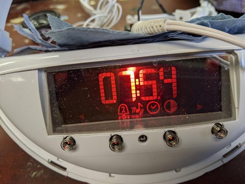

Mijn WakeUpLight type HF3521 hapert ook.
Ik heb deze nu opengemaakt, maar momenteel werkt die jammergenoeg gewoon. Dat is lastig fout zoeken.

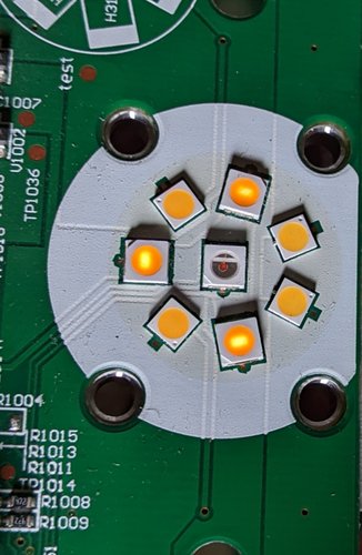

Drie van de acht led's branden zachtjes en knipperen af en toe:
De 5V meet nog altijd 5.25V, op de led-print komt deze aan als 5,20V, naast de 24V, die ik daar als 22V meet.
Ik kan op het lcd de verschillende functies selecteren, maar er komt geen geluid uit de speaker, alleen de buzzer piept bij een toetsaanslag. De led's kan ik ook niet anders laten branden. Ik zie geen gezwollen elco's maar wel wat viezigheid rond de radio-chip en bij de bandkabel:

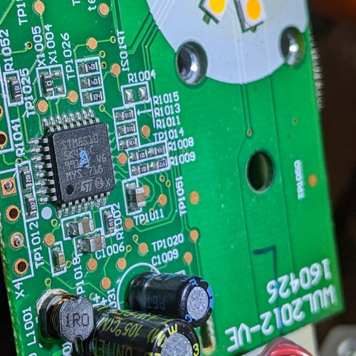

Vandaag met behulp van een donor-exemplaar de lamp weer aan de praat gekregen.
Probleem zit in het led-board, met het led-board uit de donor-lamp werkt alles weer.
De ledjes zijn op zich nog goed, als ik over het analoge stuk met mijn vinger over de testpunten ga, gaan de verschillende leds aan. Blijkbaar worden ze niet aangestuurd vanuit het processortje op de print:

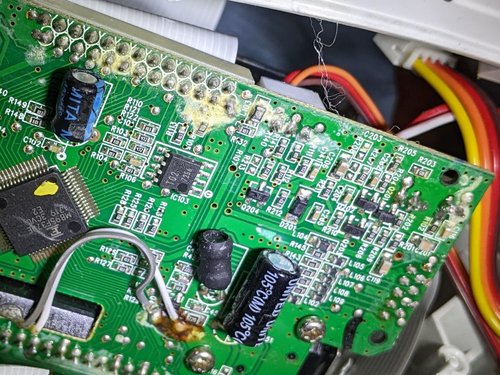

Dit is een ST STM8S105K4, volledig geïntegreerde cpu, voorgeprogrammeerd.
Als hierin iets is omgevallen, kan ik hier niets meer aan doen.
Jammer voor de wetenschap, maar ik ga de goede print uit het donor-exemplaar hierin zetten, dan heb ik in ieder geval van twee defekte een goed exemplaar gemaakt.

Op zaterdag 19 oktober 2024 19:54:34 schreef G-s:
Met een beetje geluk is hij niet leesbeveiligd (dat heb ik al vele malen meegemaakt) en kun je hem met een clone ST-LINK V2 programmer uitlezen, die heb je op AliExpress al voor ca. EUR 3. Meestal zitten de aansluitpunten voor de programmer al op de print. Dan nieuw chipje erop zetten en programmeren.

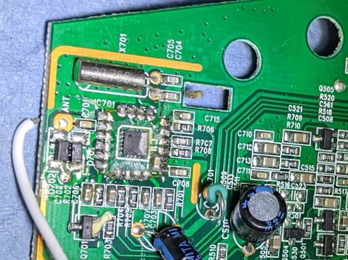

Ik zie geen gezwollen elco's maar wel wat viezigheid rond de radio-chip en bij de bandkabel:[bijlage][bijlage]
Deze heb ik nu opgepoetst en droog geblazen, maar er is geen verbetering.
Ik had eigenlijk wel goede hoop op de schoonmaakaktie, want het lijkt op een verstoring in de communicatie tussen de verschillende borden.
Het lijkt echter geen probleem met de 5V te zijn, omdat het lcd wel gewoon werkt.
Zou die viezigheid die je ziet geen residu van een lekkende C109 op het display-bord kunnen zijn? Als het seal onder het als eerste het begeeft zwellen ze niet, maar vernielen ze gewoon zonder aankondiging alle elektronica in de buurt.
Bij mijn gevonden exemplaar was die elco helemaal dood (en gezwollen) en op dat Duitse forum over deze lamp kwam ik iemand tegen die deze elco stuk had en de lampfunctie ook permanent defect bleek. Ik denk dat er misschien ergens een te hoge spanning over één van de datalijnen is gegaan via dat elektrolyt. Het inzakken van de 24V zou hier ook op wijzen.
De elco op deze plek in mijn originele wake-up light was elektrisch ook in een wat matige toestand, maar dat merkte je alleen in de metingen van de Vloss. In mijn herinnering heb ik de print van de vondeling ook schoon moeten maken op dat punt, maar ik weet het niet zeker meer. Het was nogal laat en dan documenteer je niet alles meer. Heel misschien heb ik er nog wel een foto van in het archief.
