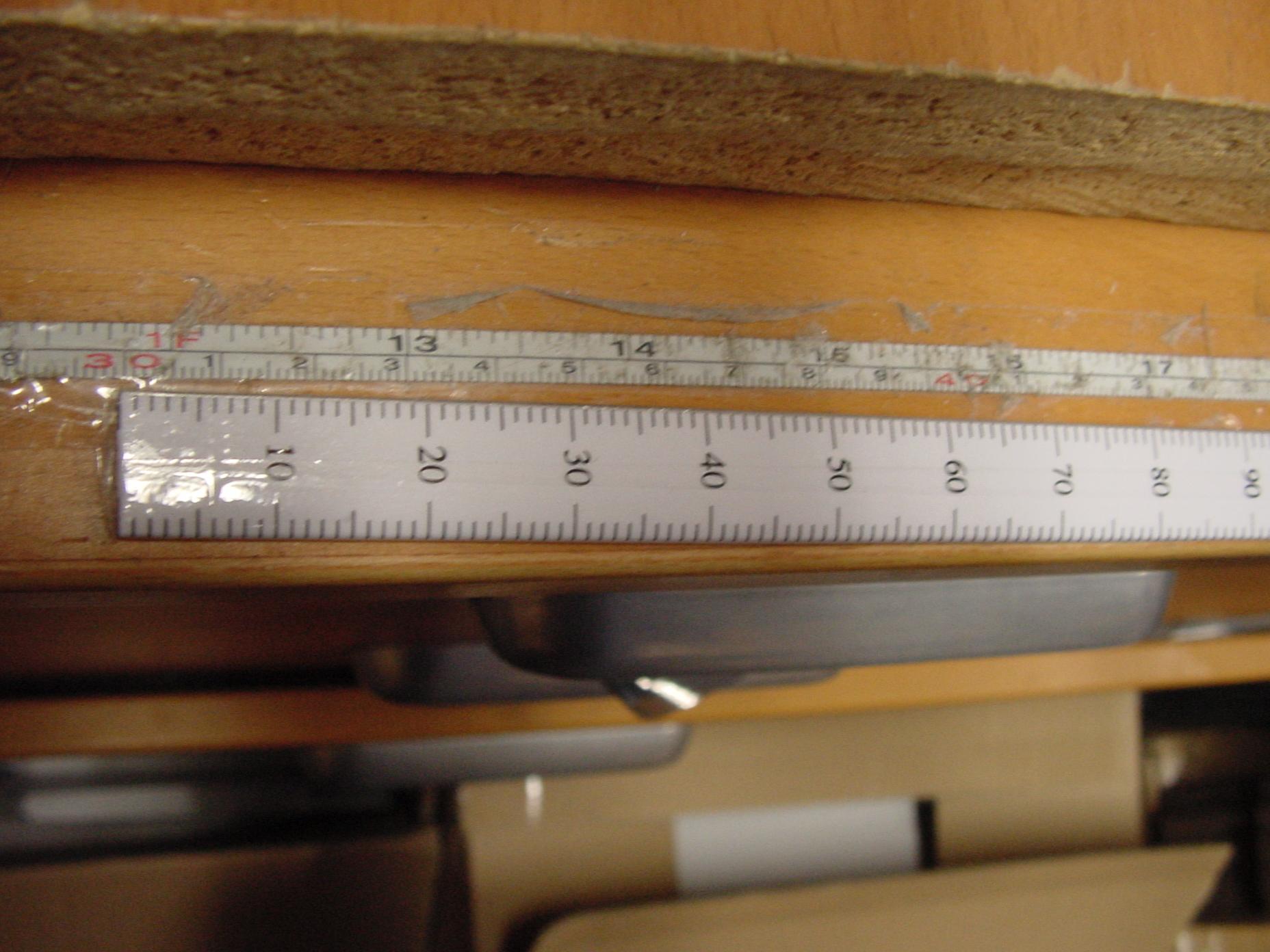

Mini projectje. Nul soldeerverbindingen.
