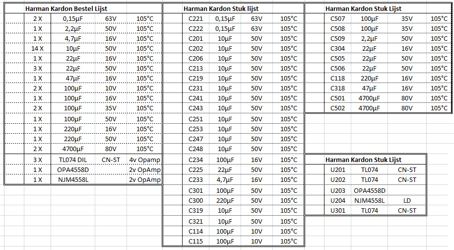

Of deze 33 Elko's vervangen en wel voor 105° type en 5 IC,
maar dan eerst goede IC-Voeten er in plaatsen.
Dan de 2 powertoren Q501 en Q502 voorzien van een koelplaat, doch wel geïsoleerd houden van elkaar.
http://www.uploadarchief.net/files/download/resized/ic_condensatoren_harman_kardon_sub.jpg
Klikbaar voor vergroting.
MVG Gerard.;)

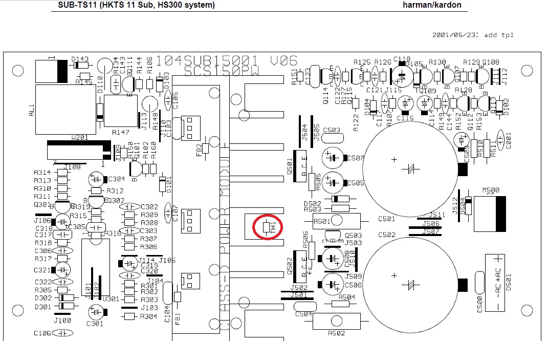

There is the PTC, the green Dot.
[Klik]
and with wite therminal-kit
[Klik]
Here the schematic: http://www.uploadarchief.net/files/download/resized/hk-ts11-th1.jpg
[Bericht gewijzigd door Henry S. op 9 september 2013 22:23:02 (18%)

Sorry , maybe some misunderstanding . With PTC I meant the ptc connection ( number 6 ) in the connection cable between filter pcb and power pcb .
I don't think you have a problem with Th1 , that's on the powerboard and is part of the protection circuit.
You have a problem with the auto / manual power on circuit ( muting circuit ). If you put the switch sw203 in the on position , this ciruit must switch to the non muted state .
The switch controls de optocoupler U1 , and U1 the base of Q206.
I measured 0,7 V when U1 is on ( not muted) en 0,35 V when U1 is off ( muted) .
